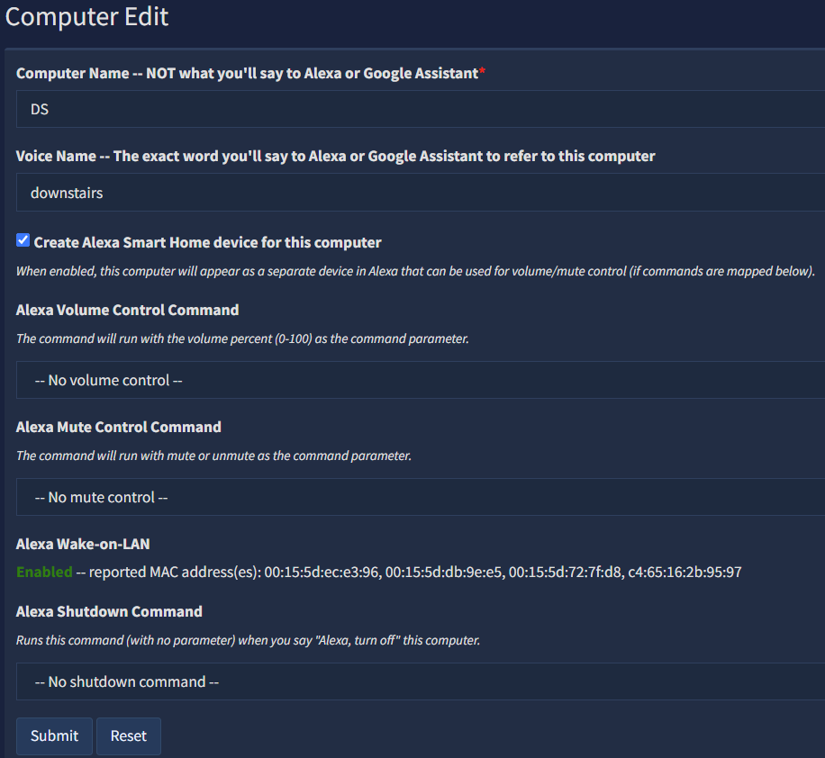

      You're right @Edwin-Zahra, I'm sorry I sent bad instructions last reply.
      To get to that Computer Edit screen, click the Edit button for the computer:
      RussR
