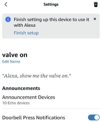

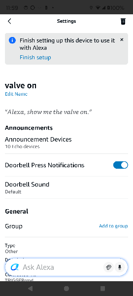

EDIT2: I added a feature to each device to allow you to disable the "Doorbell Press Notifications".

@Vinicius-Gimenez-Figuerola if you rename your command, and rename it back, it will re-create the Alexa device with this new UI option to disable the doorbell press notifications. Does that solve it? I tried to default it to false, but there doesn't seem to be a way to do that.
