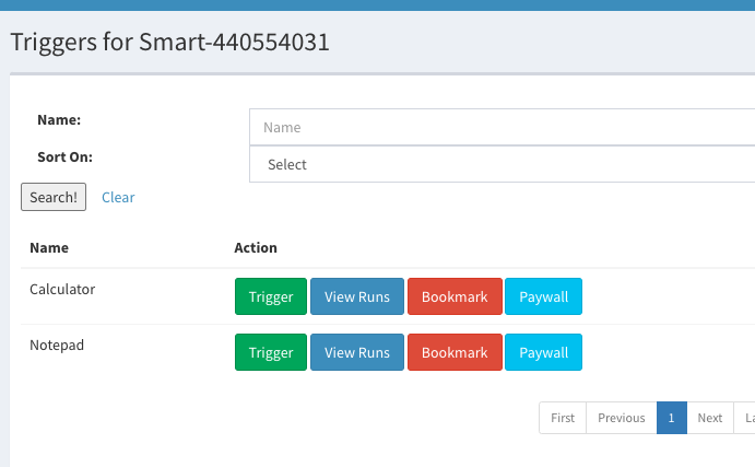

          My trigger list only shows notepad and calculator.
          This has always been the case for me but I thought it was because I was using Windows AME. This is on a standard win 11 install.

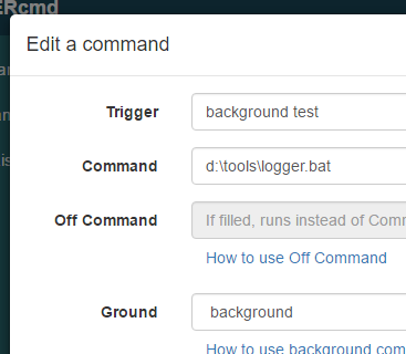

            I just tried running this d:\tools\logger.bat script in the background agent and it worked, but this is a Windows 10 machine.
            The d:\tools\logger.bat script just has this line in it:
            echo from background >> c:\background_log.txt
            I see this in my c:\background_log.txt file:
            from background
            EDIT:
            I installed the background agent on my Windows 11 box, and created my logger command as a background command. The trigger showed up in my account. I tried running it and it worked for me. I got an entry in my log when it ran.
            So I'm not sure what's going wrong on your Windows 11 machine. You could try removing and re-installing your background agent.

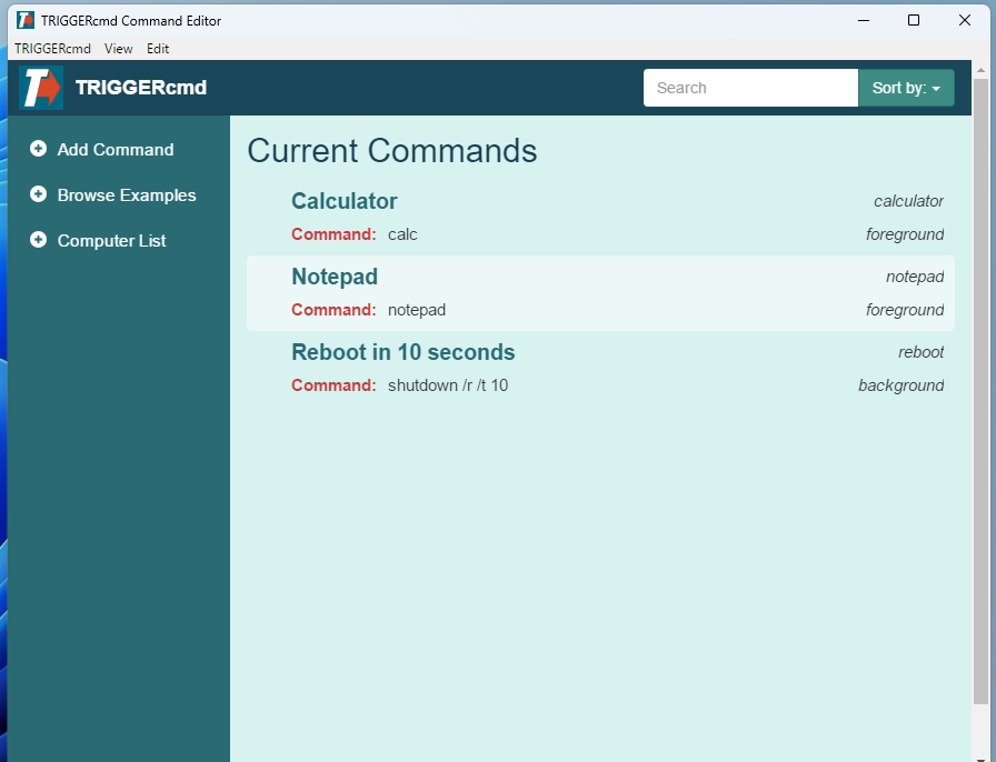

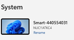

              I got you a couple of screenshots. Hope this helps.
              Agent running
              Default task still on pc
              pc name
              Triggercmd account

                    Russ @Smart Communities
                    @Smart-Communities, I don't think you're doing anything wrong, but I don't know yet what went wrong.
                    Can you try two things?
                    1. Rename the background command and see if it shows up.
                    If it doesn't, try:
                    1. Uninstall and reinstall the background agent and see if it shows up.
                    S 1 Reply Last reply Reply Quote 0

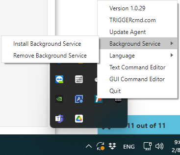

                          @Russ downloaded newest and same issue. To be clear, the background agent is automatically installed when TriggerCMD is installed. That correct?
                            @Smart-Communities, no that is not correct.
                            You install the background service by right-clicking the TRIGGERcmd tray icon and clicking Background Service - Install Background Service.
