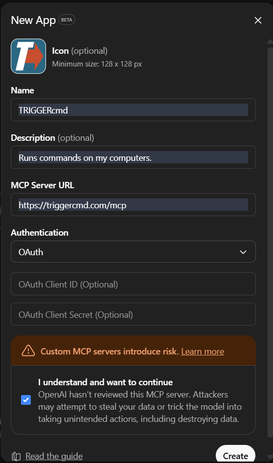

          To add the TRIGGERcmd MCP server (https://www.triggercmd.com/mcp) to your ChatGPT account:

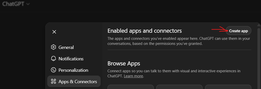

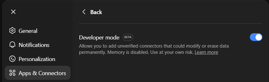

          1. Enable development mode here: https://chatgpt.com/#settings/Connectors/Advanced
          2. Go here: https://chatgpt.com/#settings/Connectors
          3. Click "Create app" and set it up like this:
