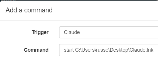

Just so it's clear to OP, he could put start c:\path\to\shortcut.lnk in the Command field or include it in his script that TRIGGERcmd could run for him. Example:
start C:\Users\russe\Desktop\Claude.lnkThen if he pre-configured the Run field of that .lnk shortcut, he could make it open Maximized.
