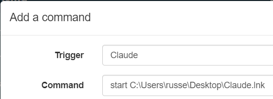

                    Just so it's clear to OP, he could put start c:\path\to\shortcut.lnk in the Command field or include it in his script that TRIGGERcmd could run for him. Example:
                    start C:\Users\russe\Desktop\Claude.lnk
                    Then if he pre-configured the Run field of that .lnk shortcut, he could make it open Maximized.

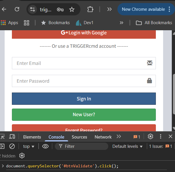

                        I know you also want to click a button on the page. I'm looking into how to run a command like this in the Chrome console using the keyboard so you could have nircmd do that part too:
                        document.querySelector('#yourButtonId').click();
                        Please try the script or command though. It worked for me.
                        This shows how I simulated clicking the Sign In button on the triggercmd.com login page using this method. Now I just need to figure out the series of keystrokes to automate it with nircmd.
