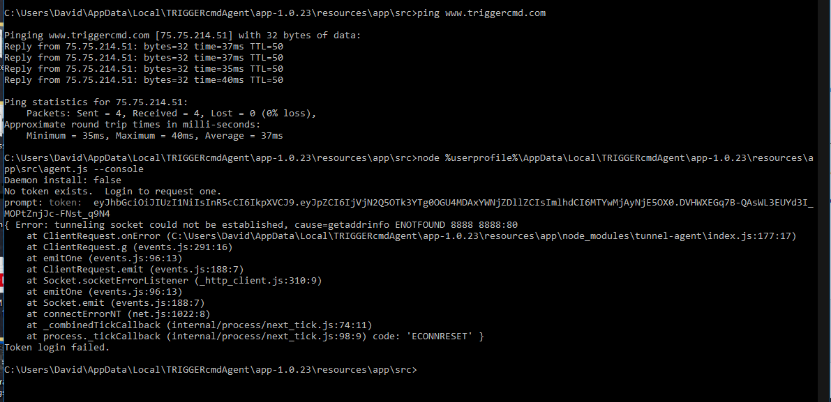

      Hey @Russ,
      Temporarily disabled Windows Firewall, unfortunately that did not work either. The other computer I got it to work on was connected to the same network. I have disabled all other background services and applications that could possibly be causing a connection block. Can't for the life of me figure out what it could be. Here is my current tasklist... Maybe you will find something suspicious or out of the ordinary:

      Hey Russ,
      Thanks for responding so quickly. Really hoping to get this back up and working soon.
      Can confirm that I can ping www.triggercmd.com, see screenshot below:
      I also tried flushing my DNS with no luck.
      I deleted my existing computer in an effort to get this working, so I shouldn't have any conflicts on that front.

      I went in and added console.log(error) into the agent.js where the "Token login failed" is being thrown and this is what got sent back:
      { Error: tunneling socket could not be established, cause=getaddrinfo ENOTFOUND 8888 8888:80
      at ClientRequest.onError (C:\Users\David\AppData\Local\TRIGGERcmdAgent\app-1.0.23\resources\app\node_modules\tunnel-agent\index.js:177:17)
      at ClientRequest.g (events.js:291:16)
      at emitOne (events.js:96:13)
      at ClientRequest.emit (events.js:188:7)
      at Socket.socketErrorListener (_http_client.js:310:9)
      at Socket.emit (events.js:188:7)
      at connectErrorNT (net.js:1022:8)
      at _combinedTickCallback (internal/process/next_tick.js:74:11)
      at process._tickCallback (internal/process/next_tick.js:98:9) code: 'ECONNRESET' }
      posted in Instructions
