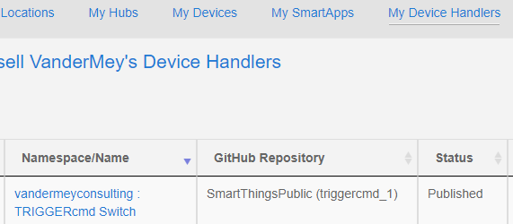

            Russ @Mitchel Follett
            @Mitchel-Follett, can you send screenshots?
            Do you get the same error in your log that mccloud showed?
            This is what mine looks like:
            SmartApp:
            Device Handler:
