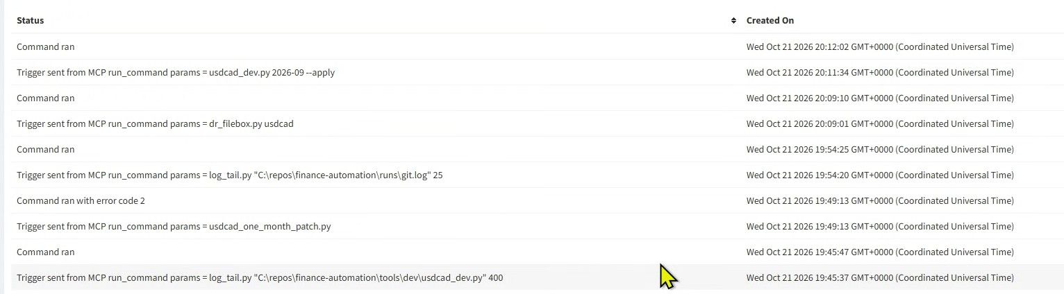

      Commands triggered through your MCP connector (sender "MCP run_command") run and the agent logs "Reported: Command Ran", but we still get "your TRIGGERcmd agent doesn't seem to be connected" emails for every run.
      Please apply the same fix you made for Home Assistant triggers.

        Can you send me a screenshot of runs list for a command that had the problem?
