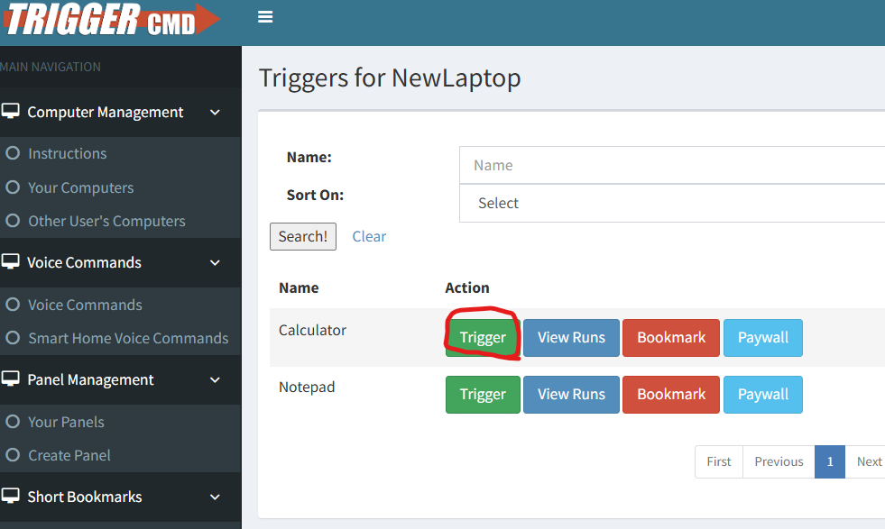

            @Leron-Tolmachev, I'm still not sure whether it works when you click the green Trigger button on the triggercmd.com website. It looks like this:
            We need to make sure that works before moving on to HA config.
            When you click that green play button in the GUI Editor, that only tests running the command locally, not via the TRIGGERcmd cloud service.
            ? 1 Reply Last reply Reply Quote 0
            • ? Offline
              [[global:former-user]] @Russ
              @Russ Gotcha, sorry if I misinterpreted your ask. The button you indicated from the website does work, both when used on the Macbook itself and when pressed on my smartphone.

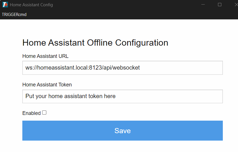

                If you've enabled the Home Assistant Offline Configuration, please try disabling it, then restart the agent. That should allow the agent to run your commands via the Internet (HA -> triggercmd.com -> agent).
                I'm thinking maybe the agent is ignoring the commands from the triggercmd.com server because the offline configuration is enabled but not working yet. It does that to avoid running your command twice - once directly from HA, and again from triggercmd.com.
                If you want to get HA offline to work, please confirm your Home Assistant server is accessible at http://homeassistant.local:8123 from your laptop.

                    For the offline config, did you generate a long-lived access token from this page?
                    http://homeassistant.local:8123/profile/security
                    And you pasted that into the that Home Assistant Token field in your Home Assistant Offline Configuration page?

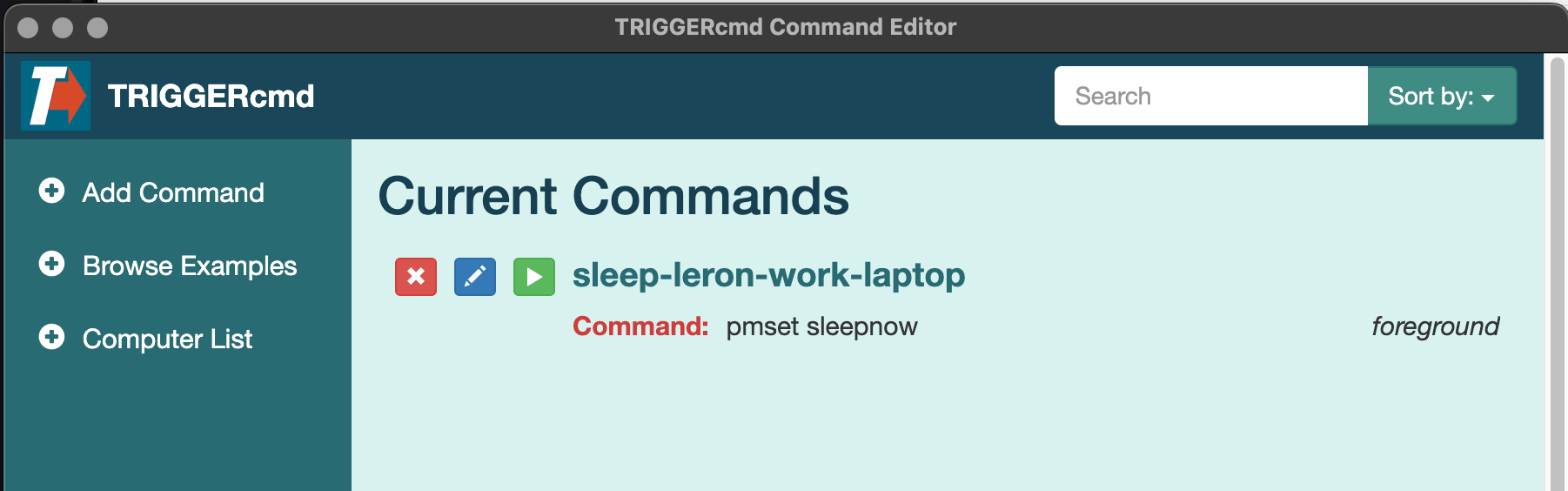

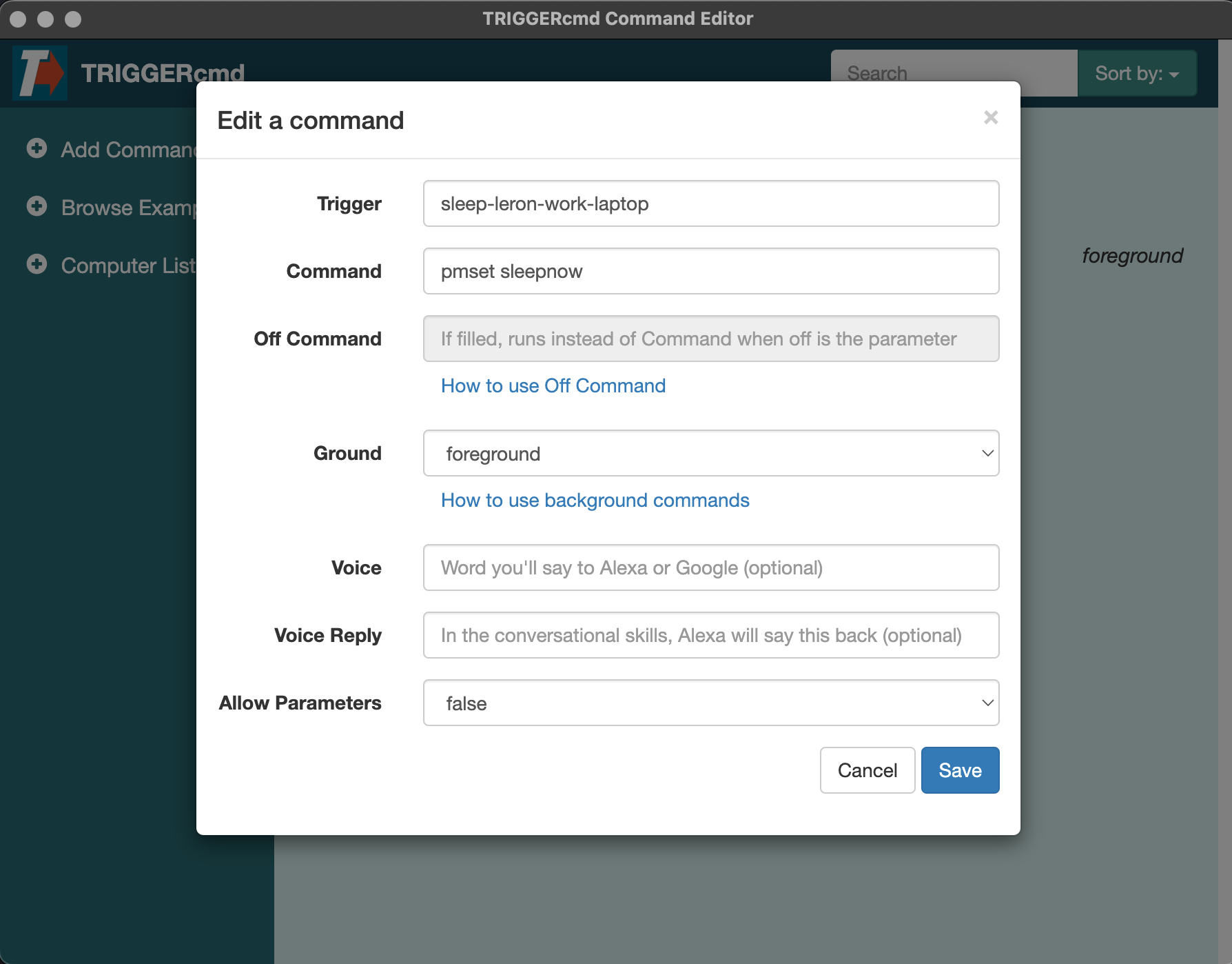

                                Can you share your command? Or ideally a screenshot from the GUI Editor? I'd like to see if I can reproduce it on my Mac.
                                • ? Offline
                                  @Russ I added a different command (to close the calculator), and I'm seeing the same results as with the sleep command: It doesn't work when triggered from HA, but does work when triggered via the website or directly via the TRIGGERcmd agent.
                                  I'm not using parameters (though I have tried doing a command with parameters, but that also didn't work, and yielded the same outcome of the log recognizing that a command was sent from HA, but not actually performing the command on the Macbook)
                                  Here's the screenshot from the GUI editor as requested:
                                    Russ @Guest
                                    @Leron-Tolmachev, I don't know why the direct from HA path isn't working. I'll see if I can reproduce the issue, but in the meantime I suggest disabling it so you can trigger commands from HA via the Internet. It seems like the connection from the agent to HA isn't working. Maybe I need to add logging to determine that.
