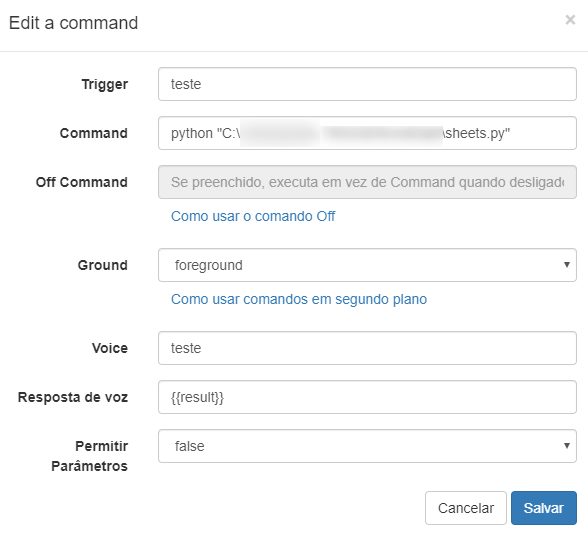

                  But I didn't understand how to put it in TriggerCMD.
                  I used the TRIGGERcmd command to execute the “test” command but Alexa only returns “no result.
                    Russ @Jonas Leite
                    @Jonas-Leite, what do you see in your results.log file in your .TRIGGERcmdData folder?
