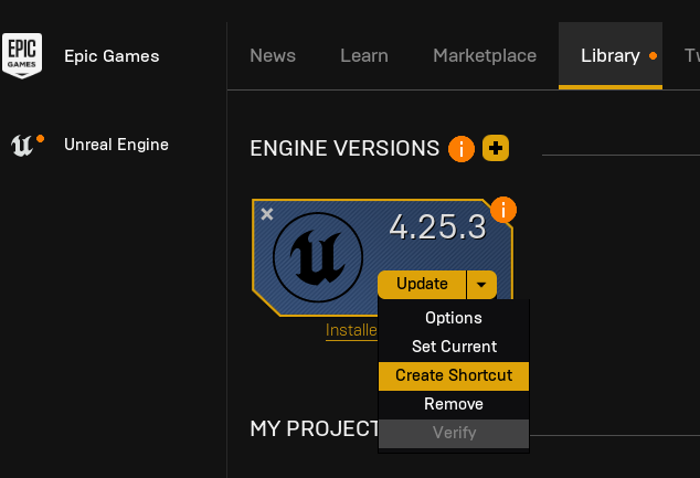

                Create a shortcut like this:

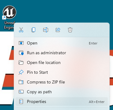

                Right-click the new shortcut on your desktop, and click Properties.

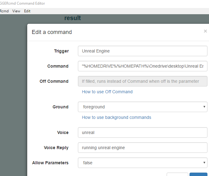

                Then make a command that runs it like this:
                "%HOMEDRIVE%%HOMEPATH%\Onedrive\desktop\Unreal Engine.lnk"
