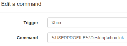

                    I created a shortcut (.lnk) file, and I'm able to run it via that shortcut like this:
                    These were my steps to create the xbox.lnk file on my desktop:
                    Open the Applications folder:
                    Right-click Xbox and click Create shortcut:
                    Now I have an Xbox.lnk file on my desktop:
                    SKRTTZS 1 Reply Last reply Reply Quote 0
                      for some reason it won't go here
                        Russ @SKRTTZ
                        @skrttz , whenever there are spaces in the command path, you have to quote it.
