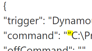

                                  Russ @drywsef
                                  @drywsef, I think I see the problem. Notice the quotes around your command are crooked:
                                  I think those are called "curly" quotes. Anyway, just delete those and re-type them in the GUI editor and it should work. I suspect you copied that path from Word or some tool that supports curly quotes.
                                  D 1 Reply Last reply Reply Quote 0
                                  • D
                                    drywsef @Russ
                                    @Russ Thanks so much! That did the trick.
