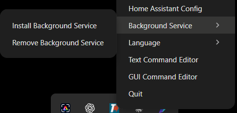

      Background commands only run if you install the background agent first.
      The background agent adds, removes, and runs background commands only.
      The foreground agent adds, removes, and runs foregound commands only.
      On Windows, background commands run in the context of the Background Service, so they run as the Local System account by default. The background commands can't display things on your screen, but because they run as the Local System account they have full access to your PC, so they can do things like reboot or stop/start other services. Also, the service starts when you boot your PC, so you don't have to be logged in for the background commands to run. Background commands won't even show up on the triggercmd.com site until you install the background service.
      On Linux it works similarly, but background commands run as root, in the context of the triggercmdagent systemd daemon after installing it with the installdaemon.sh script.
      Background commands don't work on Macs at this point because I haven't written a background service/daemon for Macs yet.
