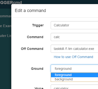

                  Russ @Jimmy David Rodriguez Farfan
                  @Jimmy-David-Rodriguez-Farfan, here's a screenshot showing the Ground field options. You don't need the background service if you only use commands with Ground = foreground.
                  • Jimmy David Rodriguez FarfanJ
                    OK Russ thanks, I changed Groud option, but I have a little question the service doesn't appear inside https://www.triggercmd.com/ why the service doesn't start correctlly? or is for other reason?
                      Thanks Russ for you help, I change the ground and automatically my trigger appeared on the website. Thanks! Now my trigger is working correclly.
