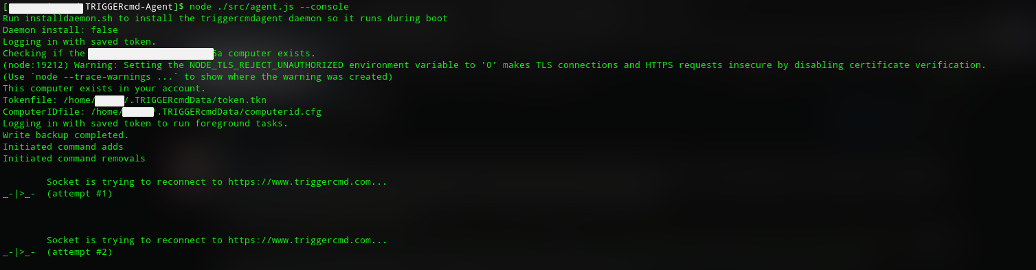

      I've used TriggerCMD in Ubuntu and Pop!_OS for a long time, and it's very useful, but now I've decided switch to Manjaro KDE, but couldn't make it work.
      I followed that tutorial.
      When I run the command node ./src/agent.js --console, that happens:
      and I can't trigger anything.
      There's anything I'm doing wrong or something I can do to fix it?

        Russ @PedroMartins
        @PedroMartins, I see that my nginx server was out of connections. Would you please try again?
        I saw this in my error.log file: "worker_connections are not enough"

          Tested it again, but unfortunatelly the same happened. Actually I've tested it a few days ago, when I switched to Manjaro, and I had that same problem.
            Russ @PedroMartins
            @PedroMartins, ok, the websocket isn't connecting but the normal traffic is. Are you accessing the internet through a proxy server? That's one reason you'd have that problem.
