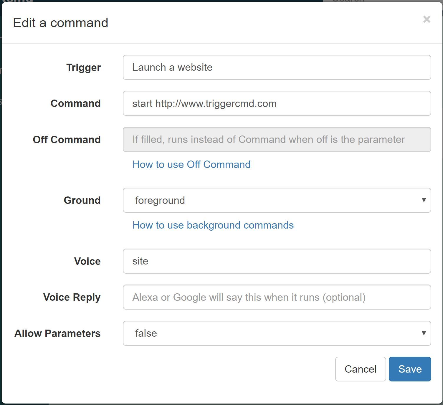

      @russ thank you for your fast reply. I really appreciate it. The firewall was blocking the commands indeed. If I try use them before login, everything works properly. But after login, when the firewall comes up, every command stop working.

    • Nothing working remotely
      Hi, Everyone! I am a facing a different issue that I searched in previous topics. I installed triggercmd but I can't able to run any command remotely. Everything works fine locally via GUI command editor. However no command works either triggercmd website or via Alexa. The command is sent, is registered in "view runs" but nothing happen. Capture_TCMD.JPG Capture_TCMD1.JPG
