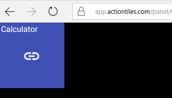

      I tried ActionTiles for the first time tonight. Nate Hales's (Bubba's) youtube video inspired me to try it.
      I wanted to see if I could skip the step of setting up a SmartThings switch for each command, so I created a shortcut tile that points to a TRIGGERcmd Bookmark URL like this one that runs Calculator on my PC:
      https://www.triggercmd.com/trigger/bookmark?token=eyJhbGciOiJIUzI1NiIsInR5cCI6IkpXVCJ9.eyJib29rbWFya3VzZXJfaWQiOiI1OGJiM2E3N2YyZjgzMTUzMjI0NzM1YjYiLCJjb21wdXRlcl9pZCI6IjU5ZDZhYjJlODRlOThkZjM2M2U2ZGY2NCIsImNvbW1hbmRfaWQiOiI1OWQ2YWIyZjg0ZTk4ZGYzNjNlNmRmNjUiLCJleHBpcmVzSW5TZWNvbmRzIjoiIiwiaWF0IjoxNTA3NDI5MjcyfQ._PHTPxVsMR-K6M4uQK3sbWuKMiJyfFzV_i-GEklt_vA
      You might not have noticed it, but you have a red Bookmark button for each TRIGGERcmd command you setup. That's how I created that URL.
      I used that URL in a shortcut tile on my ActionTiles panel that looks like this:
      Shortcut Tile
      It works pretty well on my Amazon Fire tablet using the Fully Kiosk browser, but on a regular browser it opens another tab which is awkward to have to close each time.
      On the Fully Kiosk browser that has my ActionTiles panel open, I can:
      1. Tap the Calculator tile and see two things:
        a. Calculator opens on my PC
        b. The Bookmark page for my trigger opens in the Fully Kiosk browser.
      2. Swipe down to re-run calculator if I want.
      3. Swipe up from the bottom of the tablet screen to bring up the Android back button.
      4. Tap the back button and see that Fully Kiosk closed the Bookmark page tab, and I'm back at my panel.
      EDIT 10/14/17: I submitted a feature request to ActionTiles to ask them to support an HTTP POST Webhook. That would prevent a new browser tab from popping up every time you tap the tile.
      EDIT 1/16/18: Now if you append &close=true to the end of your bookmark URL, the page will auto-close as soon as it opens. The Fully Kiosk browser honors the javascript close() command without prompting you.
      Like this: https://www.triggercmd.com/trigger/bookmark?token=BLAHtokenBLAH&close=true
