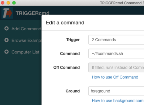

          @Arthur-Schabbach, you could make a script like this, and run that via TRIGGERcmd:
          open https://google.com
          sleep 5
          Make sure you make the script file executable with a command like this:
          chmod +x ~/2commands.sh
          Your TRIGGERcmd command can look like this:

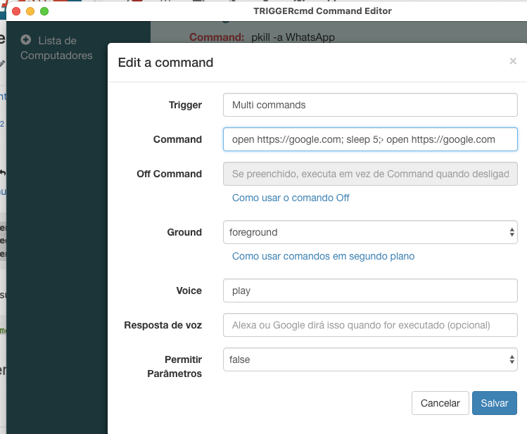

            Thanks Russ!
            also works directly on TRIGGERcmd.

              @Arthur-Schabbach, nice job! You did it without even using a script.
