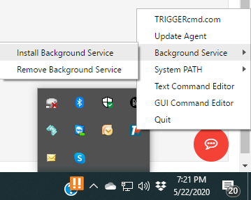

                @Mark-Hollis, I actually included a feature to run the agent in background mode in the context of a Windows service that starts up on boot. It runs your background commands elevated.
                You install it using this "Install Background Service"
                Set your commands as background commands like this:
                The normal forground agent starts up when you login, and it runs commands non-elevated.

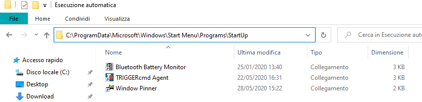

                If you still want to use a shortcut with that "Run this program as an administrator" checkbox checked, you'll need to disable UAC, and you'll need to check the box on the TRIGGERcmd Agent shortcut in this folder:
                C:\Users\Carmelo\AppData\Roaming\Microsoft\Windows\Start Menu\Programs\Startup
                This article shows how to quickly open that folder with shell:startup.

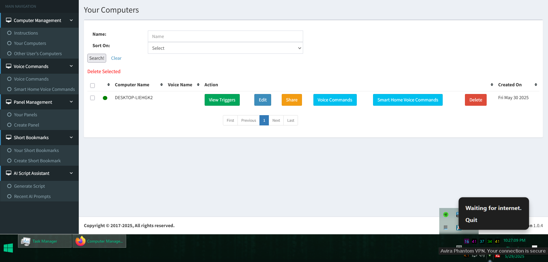

                          @trinib, I just released version 1.0.47 for Windows that will show the icon with a "Waiting for internet" message until the Internet is connected, then it will show the full tray icon menu.
                          Would you mind testing it? I tested it and it seems to work well.
                          trinibT 1 Reply Last reply Reply Quote 0
                          • trinibT Offline
                            trinib @Russ
                            @Russ Reinstalled new version and the services start properly and shows on account my computer is connected with green dot BUT it still shows waiting for internet in tray and triggers are not working,
