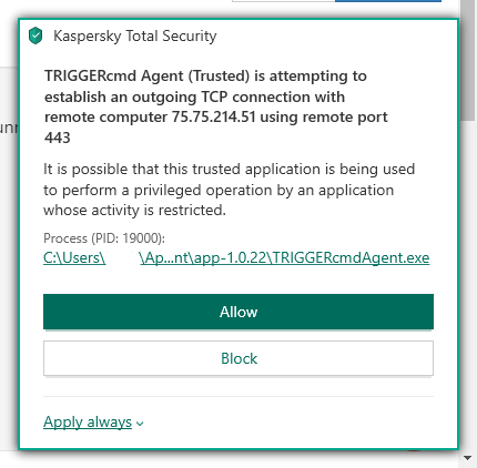

            It's having a right fit about TriggerCMD making TCP connections, and running Command Host processes!
            I've allowed it to do all these, there was lots of these boxes to allow!

                  Russ @A Former User
                  @Lewis-S, I see a "Apply always" option on your screenshot. That might prevent it from deleting the .exe. You could also exclude that folder from scans.
