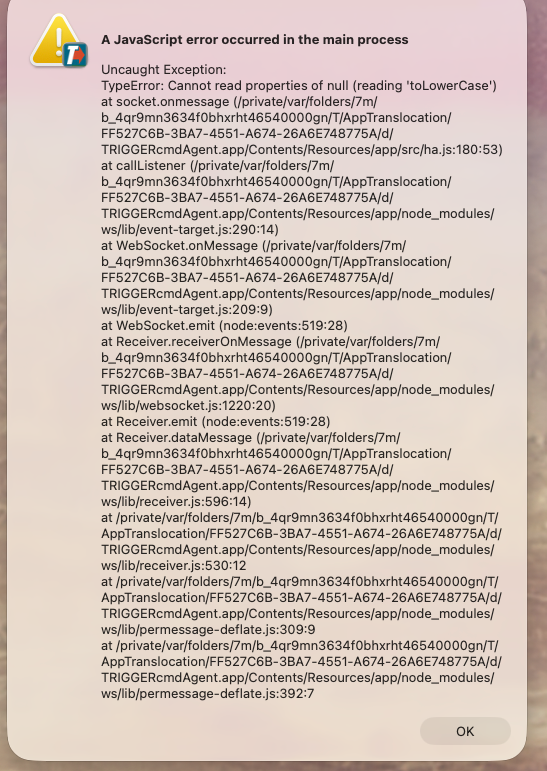

      Hi Guys,
      Need some help with this error, please.
      Not a clue....
      Any ideas how to resolve, please?
      Appreciate the support, cheers,
      Simon
        Russ @Simon
        @Simon, did you do anything right before you got this message, like click something, create a new command, or disconnect your Internet? Can you reproduce the error at-will? Any info you have would help me reproduce it so I can easily figure out how to prevent it.
        S 1 Reply Last reply Reply Quote 0
        • S
          Simon @Russ
          @Russ Hi Russ, thanks for your response. No, didn't do anything...as such. Only recently installed, I run it, works spot on, absolutely great, as expected.... but, then I leave it running....come back and see this message. Seen it loads of times now (every time). Only happens after I leave it idle for a while... Hope you can help, because it's a great bit of software, thanks.
            Russ @Simon
            @Simon, it just happened to me too. I have a bug in the 1.0.50 mac version. Sorry about that. I'm working on it now. Thank you for reporting it.
            EDIT: @Simon, I just posted a new mac version of the agent (1.0.51) that fixes this bug.

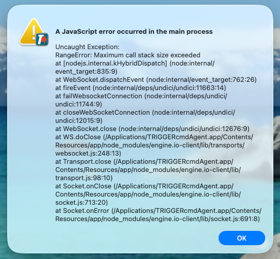

                Simon @Russ
                @Russ Hi Russ, total fresh install using new release, but come back to it this morning, and found this error.... 😞 Help please... Image 26-10-2025 at 08.38.png
                • S
                  Simon @Russ
                  @Russ Hi Russ, I have removed everything, including Home Assistant integration. Re installed again, and seems better... at the moment.... will keep an eye on it. Really appreciate your support, thank you.
                    Russ @Simon
                    @Simon thanks again for reporting the error. I'll see if I can reproduce it. It looks like it's in the Home Assistant integration. Sorry about the trouble.
                    EDIT: I see from your screenshot that this.computer_name was null for some reason, so I added code to prevent a crash when that happens. I'll produce a new version soon.
                    https://github.com/rvmey/TRIGGERcmd-Agent/commit/b54e988e7d251105bc6faa8c3fa6a5240644cbef
                    EDIT2: Done - please upgrade to the current version (v1.0.52) to avoid that error in the future.
