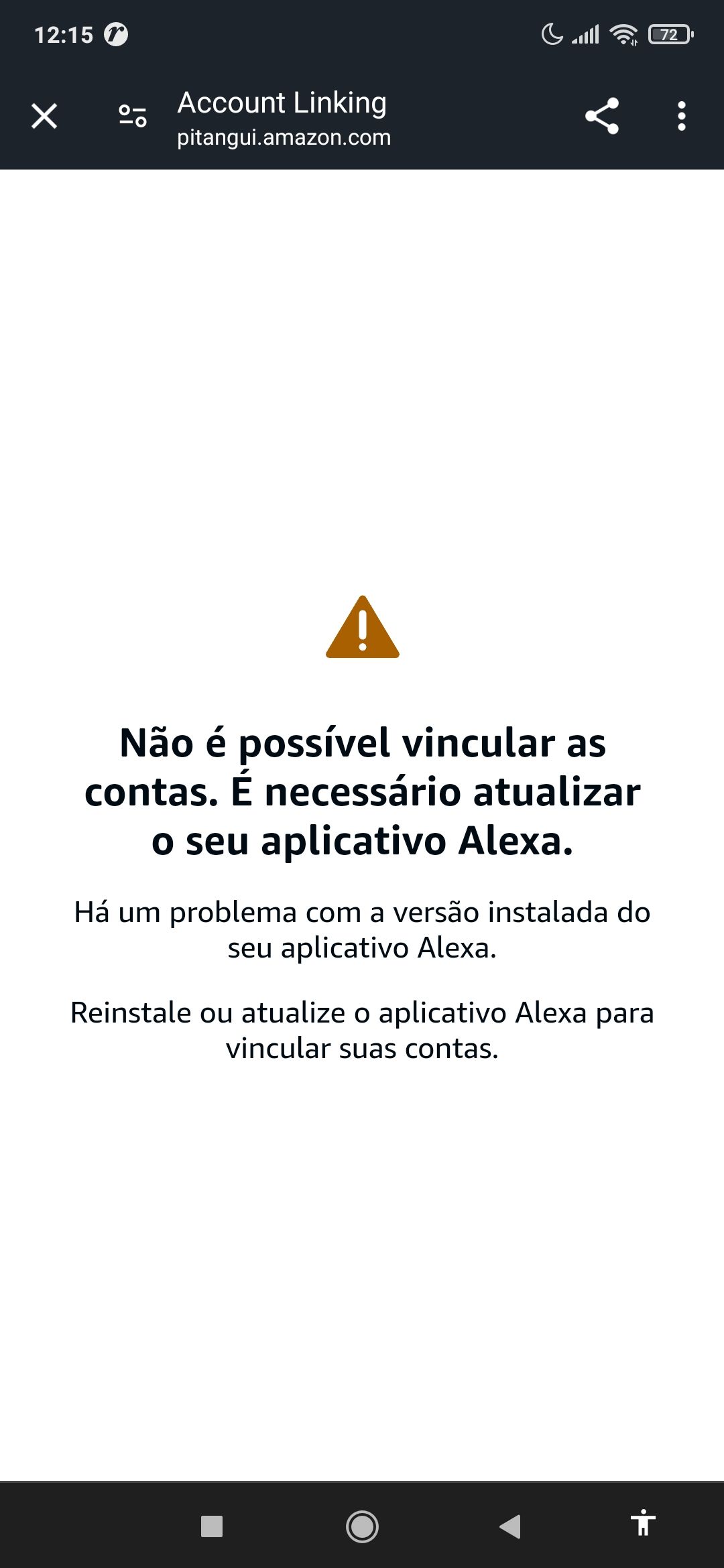

    I can't link the triggercmd skill with the alexa app on my android phone

      I've already tried with the Google account, I've tried creating via email, but the error persists

        I translated that error as:
        "Accounts cannot be linked. You need to update your Alexa app.
        There is a problem with the installed version of your Alexa app.
        Reinstall or update the Alexa app to link your accounts."

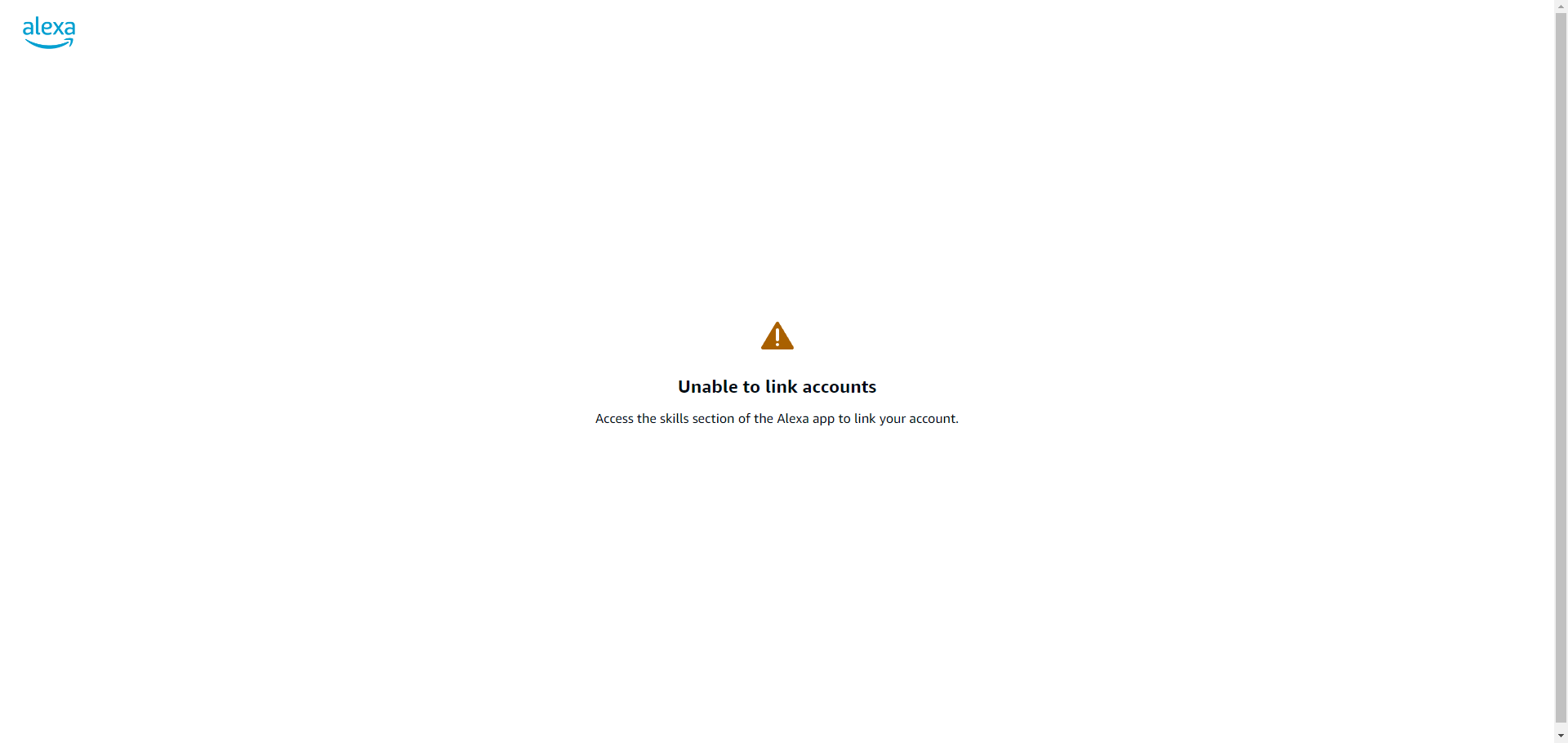

          @Russ Hi, I tried to activate via the website, but it gives the error as shown in the image, I tried to use the VPN to activate, but it doesn't work either. e também tentei todas as opções possiveis do triggerCMDCaptura de Tela (4).png

            @Lucas-Lima-Ribeiro, thank you.
            For anyone reading this, please let me know if you can link the Alexa skills to your TRIGGERcmd account.
            I can link them and my step-son can from here in the US, and I see new links getting created.
            I don't know if there's a problem in the Brazil region or not. Please tell me your region if you test it for me.

              @Russ Hello, today (06/30/2024) I tested the Amazon link again here in Brazil and it worked without any problems.
                Russ @Lucas Lima Ribeiro
                @Lucas-Lima-Ribeiro, thank you for confirming it's working!
