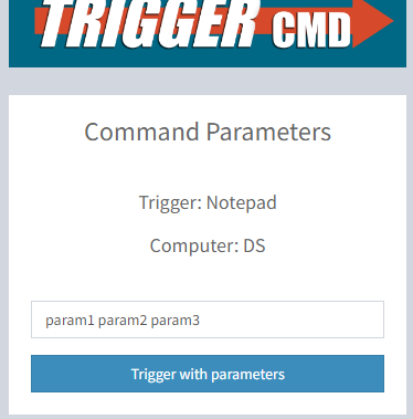

        There are other ways to run your commands though, like the original TRIGGERcmd Alexa skill, or the simplest way is to use this Parameters button for the command on the website:
        You can enter any number of parameters there:
