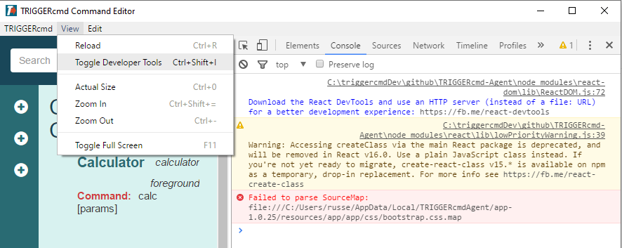

        @asdw-asdw, I wonder if your commands.json file has a problem that's preventing the GUI Command Editor from loading your commands.
        Will you please try this? Open the Text Command Editor, then copy/paste the text to a file to save it somewhere, then replace the text with this and click Save.

        Then try opening the GUI Command Editor again. If that works, then we'll know there's a problem in your current commands.json file.
        Also, in case that's not the problem, can you tell me what antivirus software and which version of Windows you're running?
        And, please toggle developer tools on, and click the Console tab. I'd like to see if there are errors in the console that would provide a clue.

            @Russ It opens the GUI command editor but doesn't let me do anything
            f876d096-63aa-40c0-aed9-7da8b88ea6f7-image.png ce2b8502-83f2-413a-8369-52f25afa852d-image.png
            I use windows defender and have windows 10
