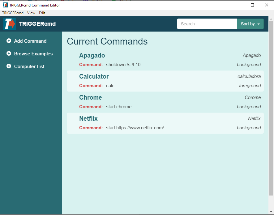

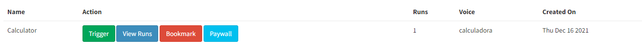

      So I'm really new at this and I'm trying to add some basic new commands but for some reason the website only recognize the Calculator default command, and Alexa as well. Can you help me?

        Russ @Andrea Carballo
        @andrea-carballo , thanks for the screenshot. I see the problem. You need to change the commands to foreground.
        Background commands only work if you install the background service. Most people don't need it though.
