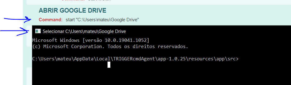

      Hi,
      Could someone tell me how I can make Trigger accept the command to open one folder? it accepts all folders whose directory has no "spaces". But Drive, thanks to the name "Google (space) Drive" doesn't.
      when I use the quotes it just opens this black screen
      the specified directory is
      C:\Users\mateu\Google Drive
      Thanks,

          Russ @Arq. Mateus Xavier Chagas
          @Arq-Mateus-Xavier-Chagas, please try this command:
          explorer "C:\Users\mateu\Google Drive"
