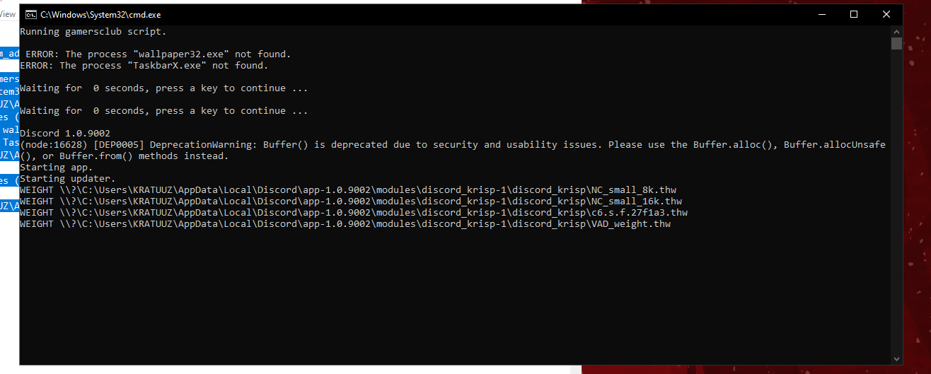

          The new problem is my discord reporting something on my cmd, I put a timout in the end as well, but didn't resolve the problem
          I hope you can help me once again XD.

            @Lucas-Marcelino, I saw the same thing when I tried running Discord.exe like you did.
            If you run discord like this you'll avoid that:
            "C:\Users\KRATUUZ\AppData\Local\Discord\Update.exe" --processStart Discord.exe
