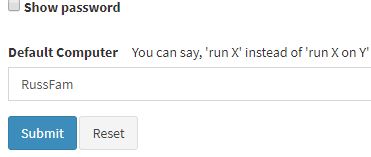

        I assume you're able to trigger the commands from the website? If so, you could try updating your default computer name in your profile.

                If your computer's name is in your Default computer field you should be able to say:
                Hey Google, ask TRIGGERcmd to run lights.
