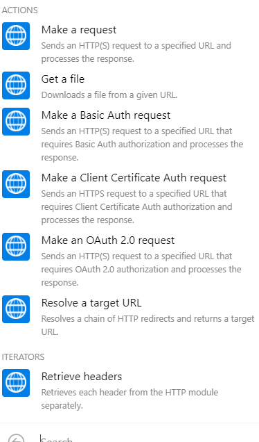

                    @Brole, do you mean you'll try using this "Make an API Call" integromat option?
                    Or do you mean you'll use this general purpose HTTP Integromat module to call the TRIGGERcmd API?

                      Right now there is only one connection.
                      Yes, I was thinking to use the general purpose HTTP integromat module to try to circumvent the issue.
                        Russ @Brole
                        @Brole, I hate to say it but that's probably a decent option because I still can't reproduce the problem. My test account is still working.
