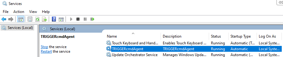

        First, about your problem with the background service, you have two options - just change the Reboot command to foreground. That will work fine as long as you always leave your computer logged in. If you want to be able to run that command while you're logged off, you need to install the background service. If you want to figure that out, please start by checking whether the TRIGGERcmdAgent service is listed when you run services.msc. It should look like this:

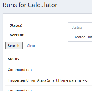

        Does your Runs list for your Calculator command show these entries?

          I really want to be able to run background commands. I checked that TRIGGERcmdAgent is listed. Today, it suddenly showed both the reboot command and another one for shutdown I made yesterday. But, after changing the trigger for shutdown, the reboot one vanished from web and from device in Amazon Alexa app. About 15 min later, it was detected again and appeared doubled in web.
          In the case of the skill, I tried saying that for both calculator and notepad. Also changed the name of calculator in case Alexa (configured in spanish) was not understanding it. In the Runs list for any of my commands I just found these two: "Command ran" and "Trigger sent from website".
