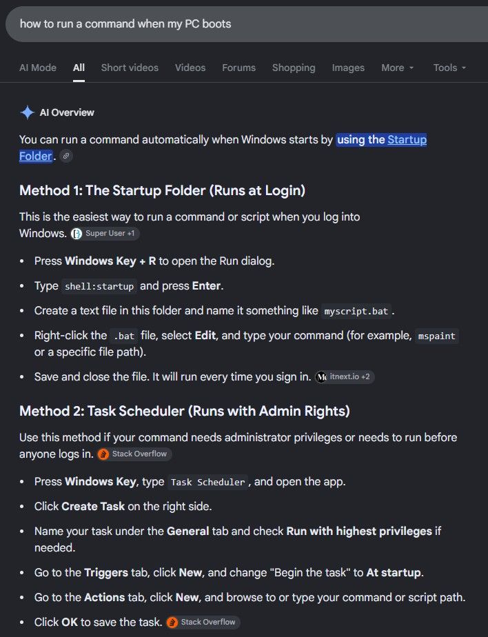

            Russ @Thiago Rodrigues
            @Thiago-Rodrigues, I think you'd have to run 2 commands:
            1. Turn on the computer and wait for it to boot.
            2. Turn on the monitor after the computer is booted.
            For #1, you could run the wakeonlan or WakeMeOnLan command from a separate computer on your network, or use this new Alexa method.
            For #2, I would not use TRIGGERcmd - I would use this method to turn on my monitor whenever the PC boots up:
