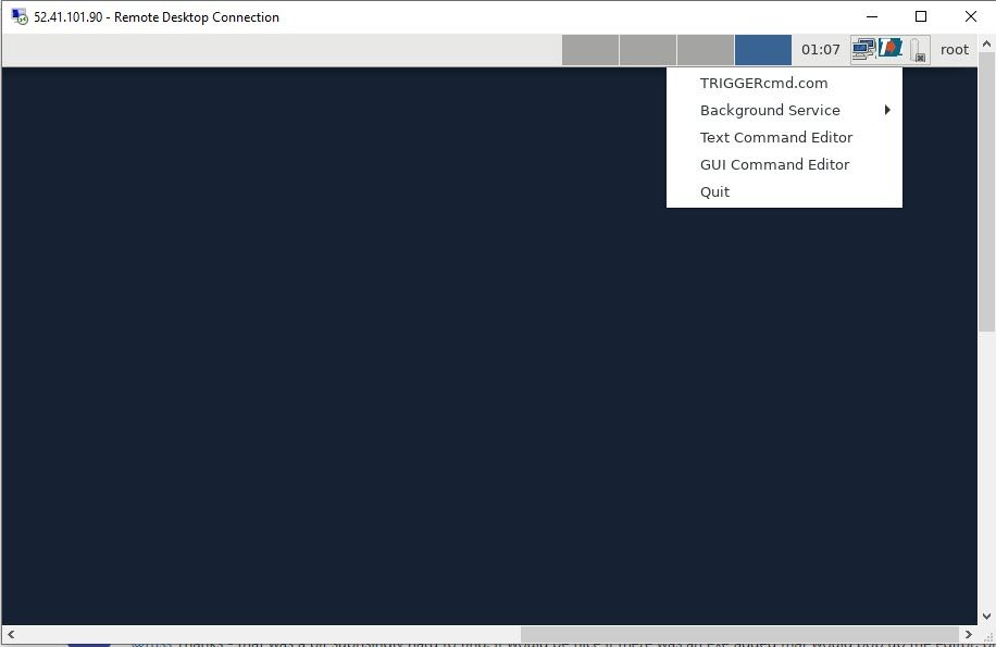

      Second, I needed to get to the gui command editor, which is this teeny-tiny red box at the top right hand corner of my screen. But, I found it
      Added a command with parameters. Tested it. It works.
      We are rocking now.

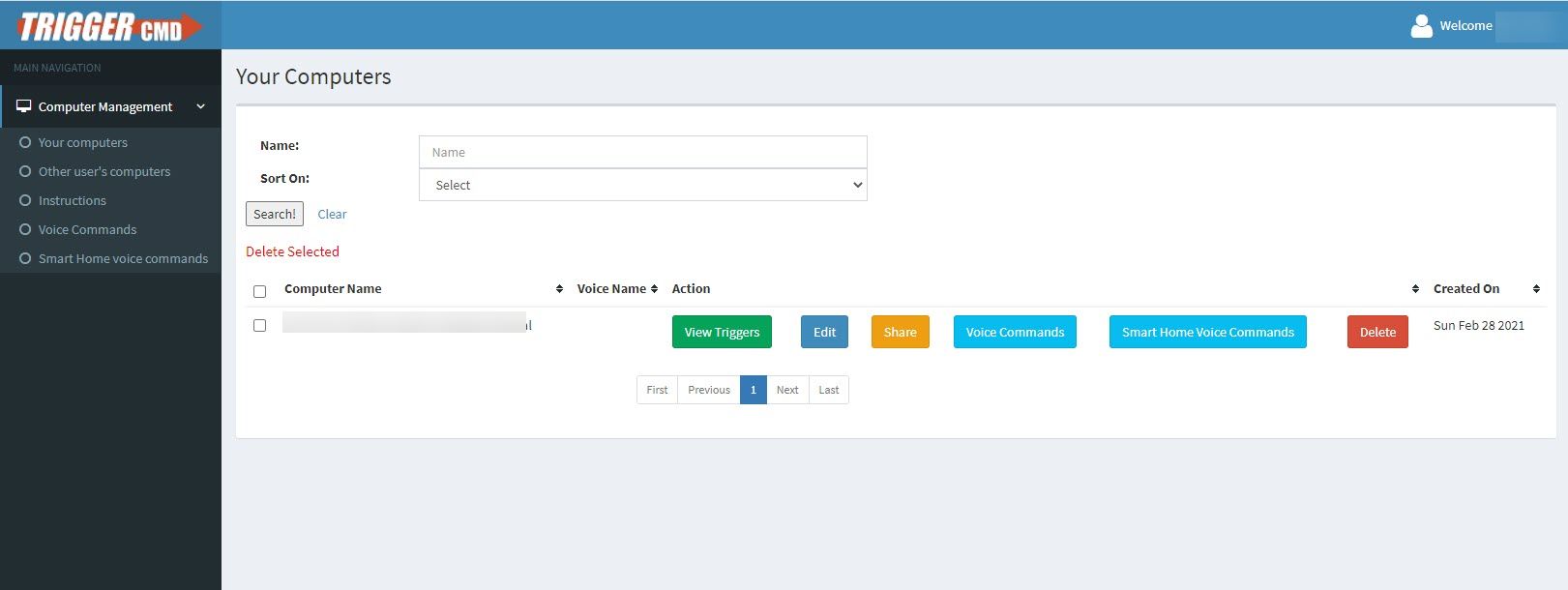

      OK, I have made a little progress. I found my token, entered it from the GUI, purchased a subscription, and now I can see my computer at: https://www.triggercmd.com/user/computer/list

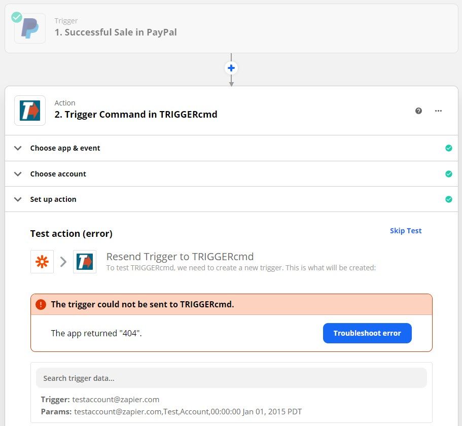

      However, when trying to create a zap using TriggerCMD, still getting "The trigger could not be sent to TRIGGERcmd" error. It's probably because I'm missing something in the instructions -- because I can't find them!!!
      TriggerCMD your computers - 2021-02-28_0-45-25.jpg TriggerCMD - The trigger could not be sent to app - 2021-02-27_20-22-32.jpg
