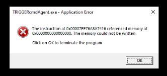

      I tried to find a link to customer support but I guess they don't have any - just the forum so hopefully someone here can help. I keep having issues with the agent stopping. The last time I did get an application error:
      but other times there is nothing - it just dies. I did try to update the agent but it still stops randomly.

        Russ @Frank Malczewski
        Hello @Frank-Malczewski, you've come to the right place for support.
        I've only seen issues like this when the Antivirus software was interferring with the agent. Is that possible in your case? What AV software do you use?
        Also you could try uninstalling and re-installing the latest version of the agent. You wouldn't lose your commands or configuration if you did. Those are stored in your C:\Users\(your user)\.TRIGGERcmdData folder which stays when you uninstall the agent.

                  @Russ So today I found it was not working again 😞 I have attached the most recent screen shot.2023-05-10 08_17_02-Window.jpg
                  Thanks.

                                @Russ Morning Russ. So I did reinstall the old version. Ran for quite a while but today my commands did not work so I checked my computer to find it crashed again:
                                As always, I just closed it and restarted it with no issue. Maybe I need to create a routine where it daily shuts down and starts up?
                                Other thoughts?
                                Frank
                                  @Frank-Malczewski, ok that's good to know at least - that it happens with the old version too.
                                  Are you using any special settings for your page file or are you using defaults? This article suggested adding more paging memory. https://www.reddit.com/r/pcgamingtechsupport/comments/t0v5fn/getting_this_error_on_elden_ring
                                  What is your Antivirus software? I might want to try running the same software to try to reproduce the issue.
                                  As a workaround, you could create a Windows scheduled task to periodically kill the agent and re-run it, like this:
                                  taskkill /f /im triggercmdagent.exe
                                  %LOCALAPPDATA%\TRIGGERcmdAgent\TRIGGERcmdAgent.exe
